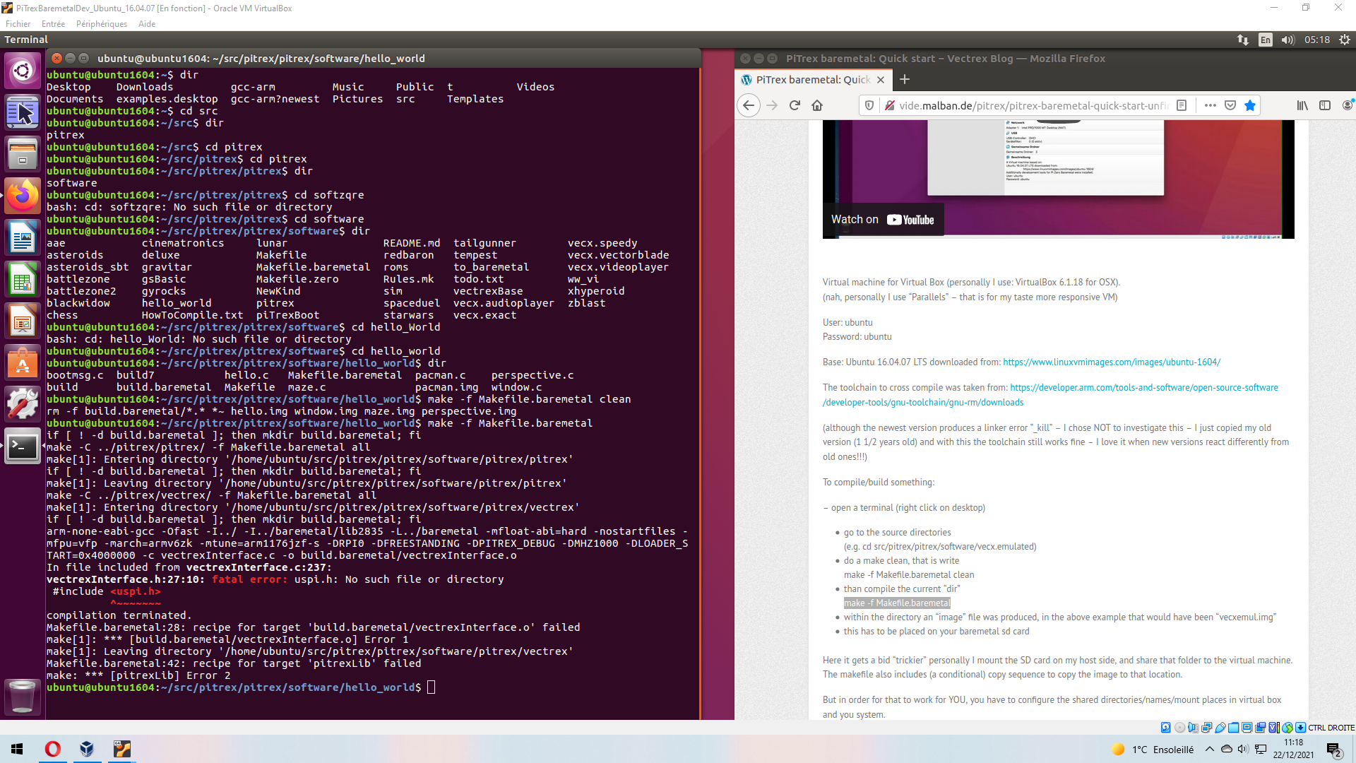

    – and… i’ve tried to use my first “make” command line. No so easy. I’ve downloaded your “Ubuntu”. I’m playing with it ! I keep you in touch (i’m a total beginner, don’t expect any help !!!)
      1. Malban Post author
        Did you install any updates, or was that the original downloaded image?
        I was under the impression, that the original image as is should have been compilable like you did.
        1. pkerga
          Hi
          indeed, i have reinstalled the ubuntu distribution and i left it as is t i can use “make”.
          I start with the “hello_world” file.
          Moreover, as an exercise, I will try to use the “Test (Demo) menu” of the Pitrex/Loader/loaderMain.c file (for which I cannot find a “test.img” file) to launch Vector Patrol with the command
          IMG_FILE_PREFIX ” vectrexexact.img “, // no start image
          “vectorpatrol.bin”, // no parameter
          – My concern is that after modifying the loadermain.c file, I cannot find the place to retrieve the data to put in the SD card. Where can I configure the output folder?
          – By modifying the Pitrex/Loader/loaderMain.c file, which final file is modified? Loader.pit ?
          – What’s the differnce between Pitrex/Loader/loaderMain.c and PiTrexBoot/LoaderBoot.c ?
          I’m still on holiday, far from my Vectrex…
          Thank you
            It is probably best to get the latest sources from github. They also should after copying them over work out of the box – and you are up to date!
