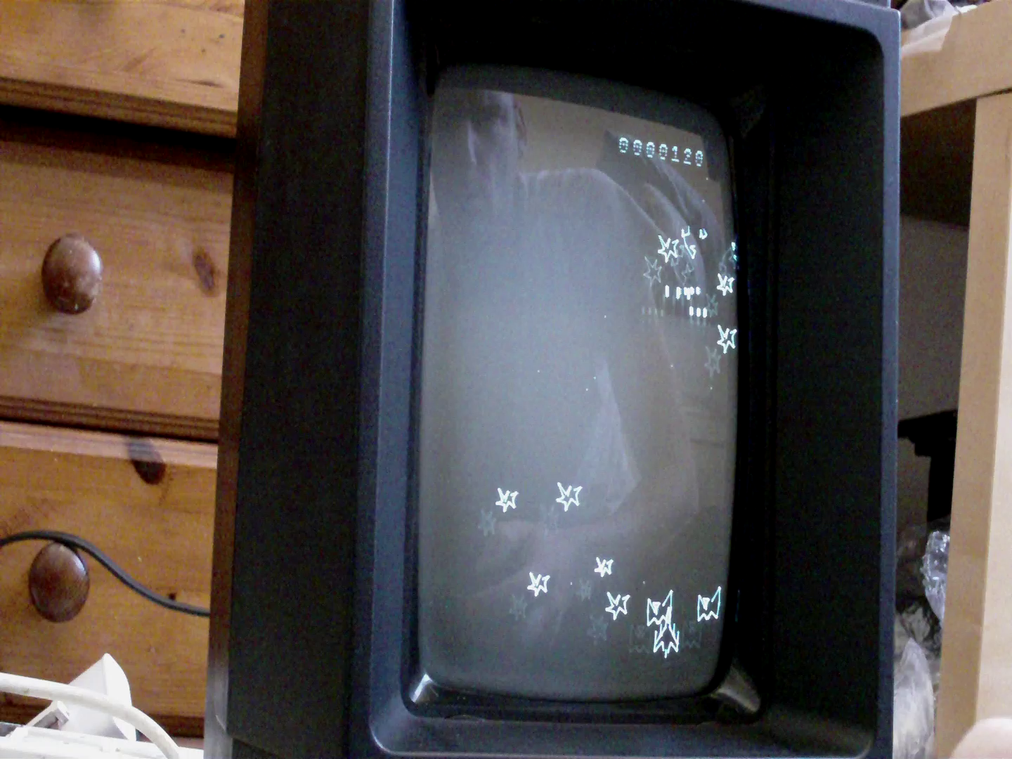

    i have successfully made a video of the game bug we have been discussing, i will be back soon with all the details and the video/screenshots (the camera i used is not very good but i notice when looking back at the video of the bug, there is a frame where you can see the bug has happened and the vectors have messed up and moved, it’s interesting to see, ok anyway i will be back shortly, i am starving so it’s lunch time now) heheh 😀
    #3036
    vtk
    Spectator
    here is the gameplay bug: (see the video inside the .zip file)
    edit: actually or maybe this issue is a bug with my vectrex.. i just thought of that 🙂
    (the rom file used was the special beta you made)
    the video:
    https://drive.google.com/uc?id=1sD28xkO5C3zFpbN2GtdxThGkG078ed3N&export=download
    http://vectrex.malban.de/tmp/BUG-Example1.avi
    note that my video camera is not very good so first off, it can only record in 30 frames per second,
    and secondly, for this video, turn up the sound volume very high so you can hear something what happens (explained below)..
    in the video, if you watch and listen very carefully (because this bug happens quickly), at approx. 8 seconds into the video, there is a high pitched beep sound which came from the vectrex when the bug occurred, and then something goes wrong with the vectors — the spiky rocks, my 2 scoopy aliens, and the background stars all ‘move’ (jump) and are instead briefly displayed up and to the right of where they are supposed to be. it looks like from the screenshots below, the player ship and possibly the bullets also, are not affected. i’m not sure if the alien ships are affected.. it is hard to tell in the video).

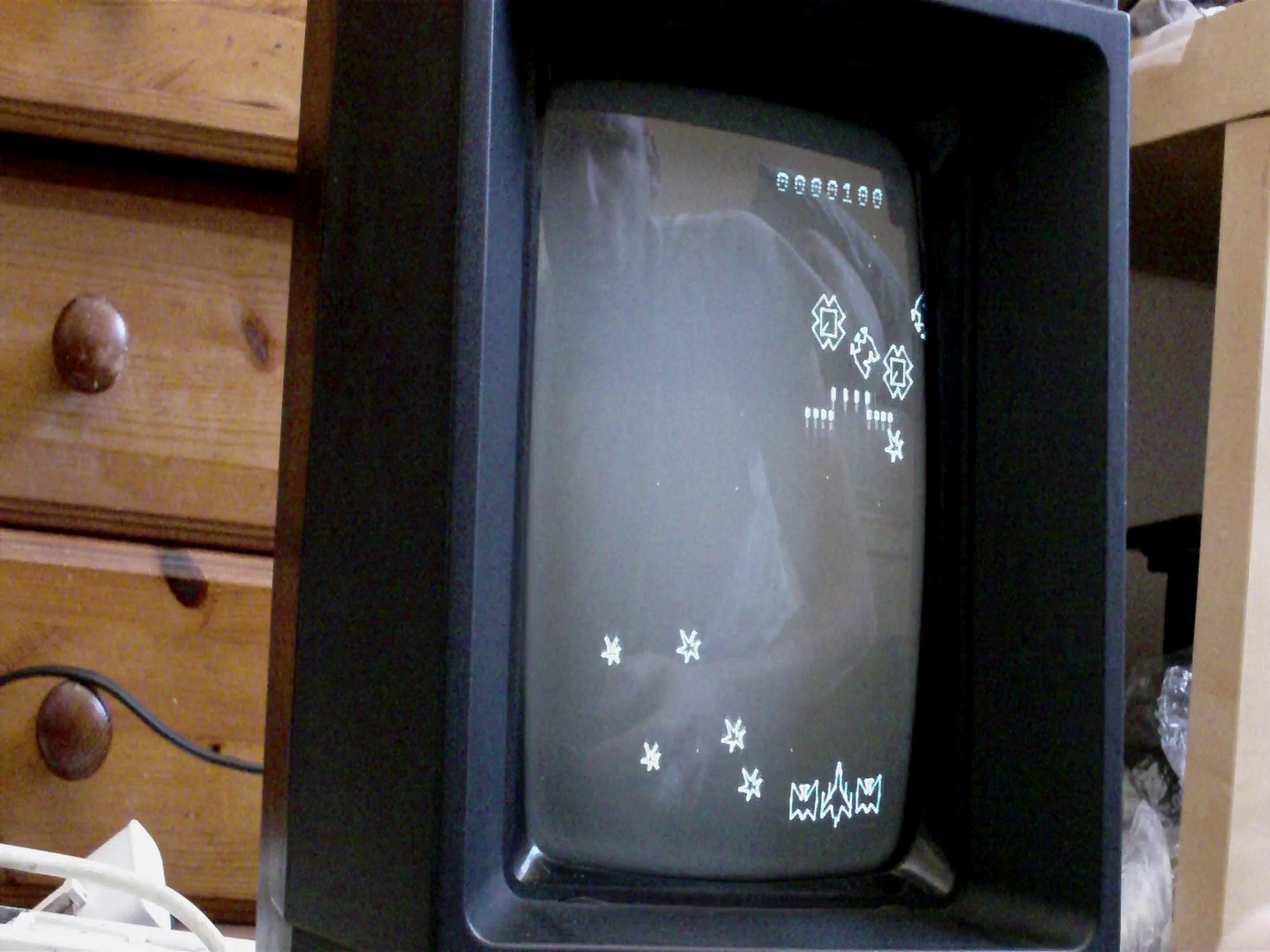

    look at these screenshots in the .zip file below for a closer look:
    screenshot 1, is just before the bug occurs..
    screenshot 2, the bug happens..
    screenshot 3, we are back to normal display.
    the screenshots:
    https://drive.google.com/uc?authuser=0&id=1jH4RiJZhR4Qb1l5RflPsD-yX9W9j6Hdj&export=download
    #3037
    Keymaster
    Wow.
    I am a bit “flabbergasted”… never seen this behaviour – that will be quite a bug hunt.
    I don’t think it is the vectrex. Notice, that the ship and the score are stable!
    The stars, the shots, the enemies and the debris are destorted and dispositioned…
    It appears also, that the last 2-3 vectors of each object are drawn out of proportion.
    It is also worth mentioning, that the player ship is drawn with the same scale and the same routines as the enemy ship.
    This makes NO sense…

    For the protocoll, the bug I fixed yesterday was (probably) the “same” as the one that occurred in your video:
    Yesterday the step were:
    The player must have a 4 shot AND scoopies.
    And the “main shot” (the middle one) must be “zero” (all shots used, so that only scoopies are left).
    And the right scoopy must still have all four shots.
    And it must be the FIRST shot on screen (the lowest shot).
    THAN 3 registeres were not initialized correctly and a crash could occur…
    The bug you showed probably was:
    And the “right” (scoopy) must be “zero” (all shots used, so that only scoopies the left scoopy shot remains).
    And the left scoopy must still have all four shots.
    (crash could also be jump to a different bank and make stupid things)
