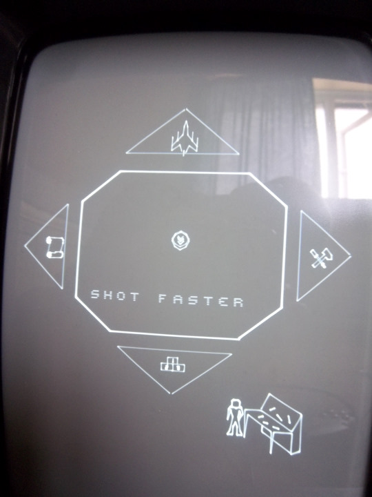

Spectatorhey just been testing the beta 27
testing notes:
i noticed at the title menu page, on my vectrex most of the time the left icon (and the top one?) seem to be off-centre inside the triangle, see the first picture below
intro animation: i think it would be a good idea here to do what you did with the boss fights:- have a eg. 3 second duration at the start of the intro animation where you cannot skip the animation via button press, so that it is not skipped by mistake as it starts, and also, after the 3 seconds if the player presses the button to skip the intro animation, it would look better (more professional) if the screen went black/music stops for eg. 0.5 or 1 second before displaying the title menu screen

shop: i noticed that a lot of times, on my vectrex the bottom (line) of the alien body does not properly line up (overlap) with the line he is resting on. i think it certainly looks better when it is lined up properly rather than overhanging (see picture 2 below where he is overhanging)
