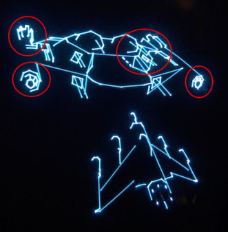

    i got far tonight with the beta21 build
    excellent fun 🙂 i got through all 100 EASY levels and then continued onwards to around thirty something of the NORMAL levels
    final score: 570,000
    final rank: ADMIRAL 2 BRONZE STARS
    some random thoughts and questions in no particular order:
    im wondering how the shield works, when you take a hit… – so, we know there are different ways you can take hits, it could be a single enemy bullet, or something like a spiky falling rock which could fall ‘through’ you. how does the ‘check’ work on the shield? :- after you take any kind of hit so the shield is gone, should your ship be invincible for one second so at least you can move out of the way of whatever hit, or is hitting you? (so, if a spiky rock hits you (falling through you), then you wont lose the shield and then a life all in an instant) .. hopefully i explained that ok. if not, what i am trying to say is, for the shield, if anything hits you, can it be set so that: you lose the shield but then are invincible for one second, so u can move away from something (eg. a spiky rock), which took away your shield and is still hitting you, (so, then you avoid losing the shield plus a life all at once in the blink of an eye…)
    some thoughts about the final level 100 boss: i had autofire+laser combined, and he is way too easy. he can be killed way too quickly (in a couple of seconds. it’s no challenge so unfortunately it feels like an anti-climax). the 2nd and 3rd bosses take some time to kill even with the laser+autofire (several seconds) – in my opinion the final level 100 boss should also take some time and be more of a challenge if you have the powerful laser+autofire weapon
    also on the subject of the final boss, i just wanted to say that it was certainly great to see some new gfx for the boss intro animation screen, but i felt that unlike the previous gfx from Jacek; with this final boss, on the real vectrex screen it seems that there are too many vectors crammed into a small space in some parts of the ship (i have circled problem areas in the picture below.. note: sorry i didnt take a photo of my vectrex screen – so you cant see the actual issue as i saw it). i can see from the picture below that those tight vectors look clearer if viewed in VIDE, or perhaps on a real vectrex with the brightness level turned down low, but here on my vectrex with the brightness knob set as standard (..set so that the white dot in the centre of the screen just disappears.. note: this is a very common and ‘standard’ brightness setting used by vectrex owners…), well… then particularly those circled areas in the picture below look like there are too many vectors packed into a small space, so unfortunately you can’t see any of the intended intricate detail at all 🙁 but instead, just an area of bright white and a messy appearance of ‘lots of vectors packed into a small area of the screen’, which is not consistent with the previous boss animation screens (which of course are excellent) 🙂
    on a different note now:
    i noticed after i finished playing and went into game settings, now i can see in settings it is set to difficulty NORMAL. however i noticed now i cant change it back to EASY if i wanted to play in EASY mode again? i reset the vectrex, and then went into settings, and it was showing EASY again. then i noticed i could change it to NORMAL if i wanted.. however now again, i cant change it back to EASY (i have to reset the vectrex to get it back to EASY again)
    ps. also in the settings screen, i noticed for me, i cant get the entries: SECRETS and RESET to do anything (work in progress?)
    https://i.postimg.cc/PJ4nQB61/pic736473.jpg

    …with this final boss, on the real vectrex screen it seems that there are too many vectors crammed into a small space in some parts of the ship (i have circled problem areas in the picture below…
    Check the next beta – I have uploaded a new bin in the “privateBeta” directory called “Boss4Intensity.bin”, check that out – better? (I reduced some intensity)

    nice work with the boss4intensity.bin, i just tried it, that’s much better yes, i can see the detail now and it looks much better 🙂
