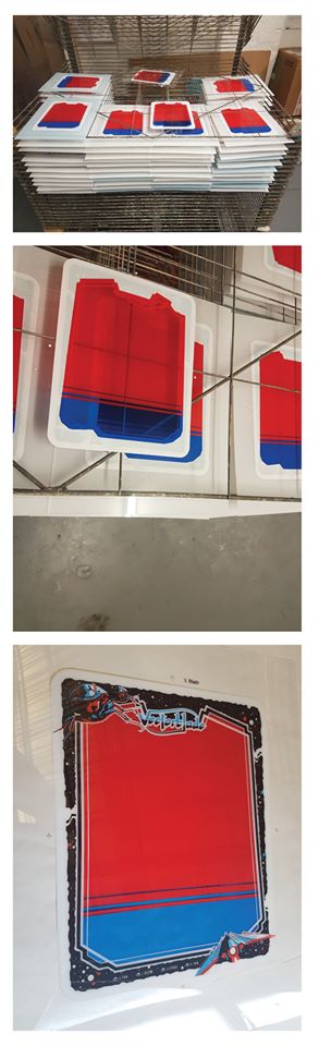

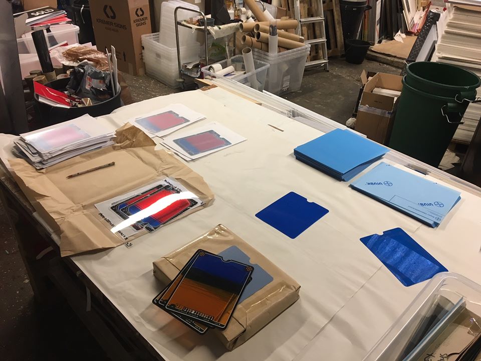

PeerEDIT: Cool, the overlays look great!

All overlays are on its way to Germany.
