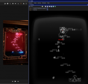

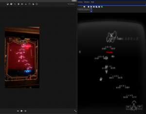

KeymasterIn level 4 are the first “visual” differences:
Still the same
1/2 second later
(on the real vectrex, the ship starts to move right!)
Ehm.
Now what – how do I find the “code”/”bin” difference?
