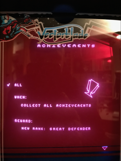

PeerApril 23, 2020 at 7:26 am #5064Malban
Keymasterafter my latest “negative” finds – I did lots and lots of testing (including the watchdog in Vide).
Real console proof of much testing: see image
As much as I like Vectorblade – there comes a stage where you get sick of playing hours on end.
I also played in parallel (ok, ok sequentially) in Vide.
No crash. In either the real and emulated game.
While theoretically it is wonderful to have no crash – the already found bugs can not explain all “old reported” crashes, so I must assume some bug still resides, but does not show itself at the moment.
