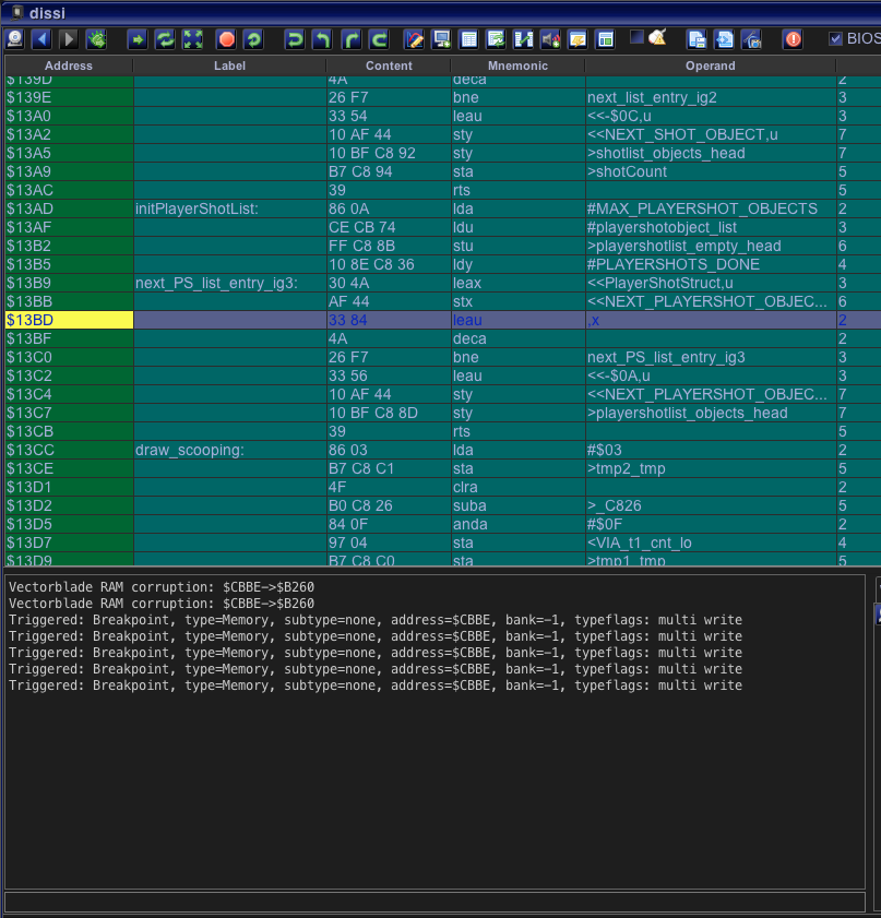

I wrote a special function, to watch all RAM pointers. Stupid boring function:boolean checkRAMPointers() { int[] toCheck= { // enemy shots 0xc903+0*12, 0xc903+1*12, 0xc903+2*12, 0xc903+3*12, 0xc903+4*12, 0xc903+5*12, 0xc903+6*12, 0xc903+7*12, // BONUS 0xc963+8*0, 0xc963+8*1, 0xc963+8*2, 0xc963+8*3, 0xc963+8*4, 0xc963+8*5, // stars 0xc993+0*13, 0xc993+1*13, 0xc993+2*13, 0xc993+3*13, 0xc993+4*13, // enemies 0xc9d4+0*21, 0xc9d4+1*21, 0xc9d4+2*21, 0xc9d4+3*21, 0xc9d4+4*21, 0xc9d4+5*21, 0xc9d4+6*21, 0xc9d4+7*21, 0xc9d4+8*21, 0xc9d4+9*21, 0xc9d4+10*21, 0xc9d4+11*21, 0xc9d4+12*21, 0xc9d4+13*21, 0xc9d4+14*21, 0xc9d4+15*21, 0xc9d4+16*21, 0xc9d4+17*21, 0xc9d4+18*21, 0xc9d4+19*21, // player shots 0xcb78+0*10, 0xcb78+1*10, 0xcb78+2*10, 0xcb78+3*10, 0xcb78+4*10, 0xcb78+5*10, 0xcb78+6*10, 0xcb78+7*10, 0xcb78+8*10, 0xcb78+9*10, }; for (int i=0; i<toCheck.length; i++) { if (getPC() == 0x53a) // main loop start { int ram = e6809_readOnly8(toCheck[i])*256+e6809_readOnly8(toCheck[i]+1); if (ram < 0xc800) { breakpointExit=EMU_EXIT_BREAKPOINT_BREAK; CSAMainFrame frame = (CSAMainFrame) Configuration.getConfiguration().getMainFrame(); DissiPanel dissi = frame.checkDissi(); if (dissi != null) { dissi.printMessage("Vectorblade RAM corruption: "+String.format("$%04X", toCheck[i])+"->"+String.format("$%04X", ram), DissiPanel.MESSAGE_INFO ); } return true; } } } return false; }And played… and played… (in Vide).
In level 96, the “breakpoint” triggered!
There was a RAM Pointer corruption in the player shot object!
(PlayerShot 8 to be exact – nowhere near the stack)Silly me, I switch off “stepping” back, so I could not figure out what happened (inspite me having a save game only 10 seconds before the fault).
But this mean:
- there is another bug, that I CAN figure out using Vide! – if I am patient
- perhaps that is the final!
- I might add a new feature to Vide – to save states automatically every XX round…
- I defenitly will not switch off “take steps back” the next time.
CHEERS

April 21, 2020 at 9:06 pm #5060Malban
Keymaster🙁
False alarm… didn’t find anything “new” 🙁
Gee I feel dumb sometimes. Perhaps double checking befor posting would not be a bad idea…
