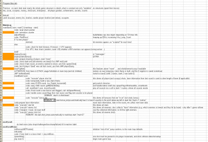

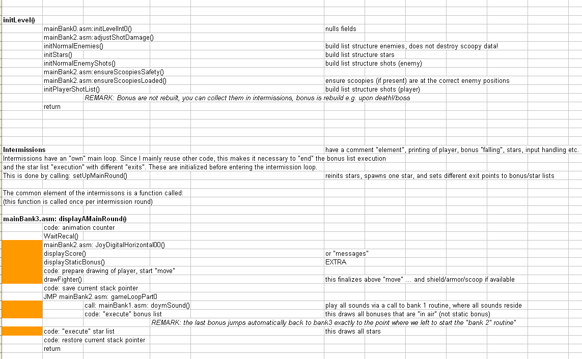

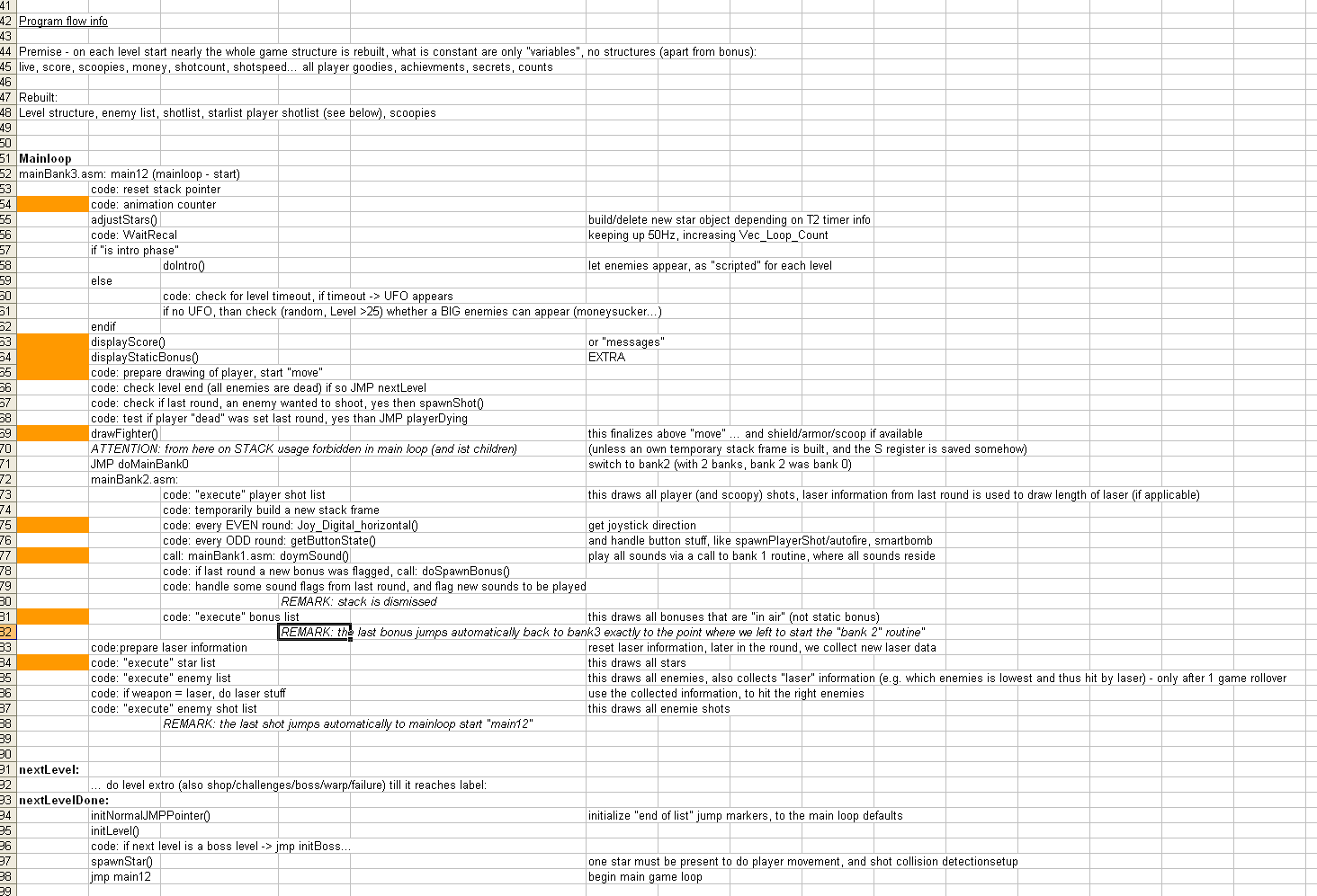

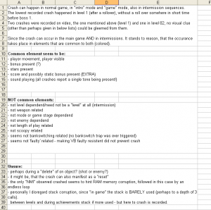

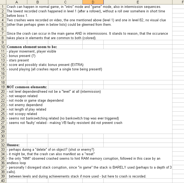

But still – I could not let it rest… I’ve written down my current “knowledge”… some images….
April 18, 2020 at 7:50 pm #5044Peer
SpectatorOne remark in respect of lines 37-39:
If the stack goes too deep due to some call of a routine f(), and thus overwrites (corrupts) heap data D, the crash must not neccessarily occur during f(), but only when the corrupted data D is used the next time. This can be much later, and in a different piece of code.
- the “non debug” stack starts at $cbfc, and thus overwriting all vectors
